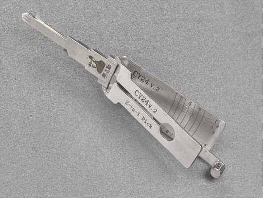

Maybe you want a Lishi just for Chryslers
