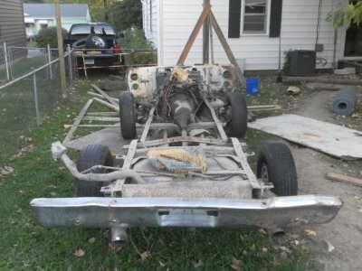

I'm going to do a super low Pro Touring RamCharger using most of this frame

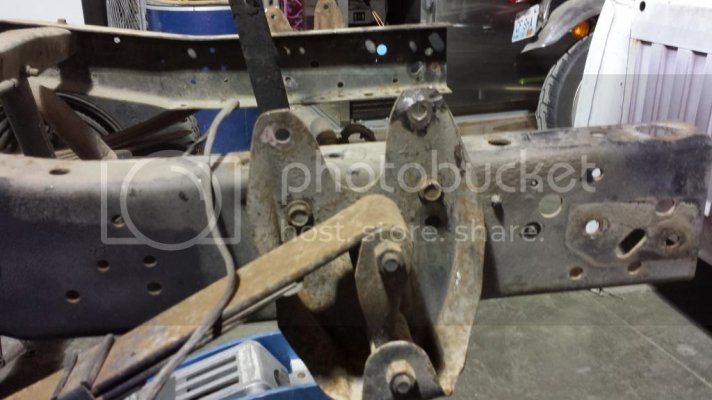

Here's 7"rear with a flip & moving the rear spring hangers up on the frame 3" with a 29" tire 255/70/15
5" front Van LCA's stock springs 25 1/2" tire 225/60/15
When I move the hangers I move the bottom riveted holes to the top ones bolt them in & drill the hole in the hanger you see in the pic through the frame
The forward hole I try to do the same spacing
When you do this you can tune your height in the rear 1" at a time
You have to cut the pieces sticking up off to clear the crossmember on the floor of the bed

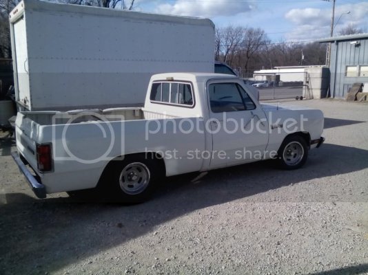

This is my 1st gen cummins short bed
[/URL][/IMG]
