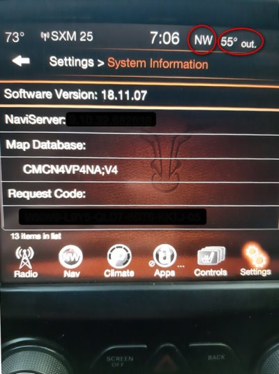

Did you check in Cust.Set.Menu.2, US/Metric CSM Present: Yes ?
Note: On my 8.4", it shows temp (in imperial) and compass heading. In Cust.Set.Menu.2 the "Tempature Unit CSM Present:" is set to No. That is actually the way it is spelled in the menu.

The 8.4 radio is what I am referring too, also (have premium cluster also). But, mine is a 2016 and yours is a '20, so there may be some differences on this outside air temp programming..
What I found helps me is that I printed the text of the program into a PDF file, then I can search for key words with Acrobat Pro.

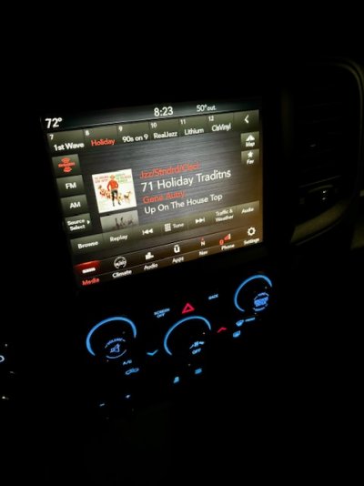

I finally got it to work. Not sure how to add the compass at the top on the 8.4 radio with alpha obd but its on the bottom of my Nav button and on my evic.
