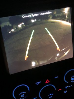

I got it all put in upgraded a 2014 to a uas Everything works except the back up camera doesn’t come on when I go in reverse
But if I push the back up camera button the image shows up perfectly yet it says Camera not available
In reverse I don’t even get a screen change
I am suspicious that the fact that I have a manual makes a difference
On the ra4 that I had my back up camera only gave me a black screen that would show up when I put it in reverse
But I suspect that was a radio issue as I have a RA3 and that worked fine neither of them had the back up icon though
The film wire version is 21.1

@ManualCummins, 2017 G56 here, having the same issue after the swap. I have a reverse camera and the cargo camera, and both readouts have the same "camera unavailable" readout, and the reverse camera doesn't come on when I put it in reverse. I do have the radio buttons to turn them on though, luckily, so that's been the temporary solution. I can only image that the wiring must be different between the G56 and the auto trucks, or there's a software issue. The real question is if there are any true-blue 2018 G56 trucks with the 4C/UAQ radios and what their wiring/software is doing. I'm concerned that all the 2018 trucks with Android auto were automatic trans trucks.

Yeah, I would like to know what a factory 8.4 truck with manual trans does. I know this has popped up before, but there just aren't enough of you all out there with that setup to know what's supposed to happen.

Wanted to thank Mpgrimm2 and Deereguy for the harness and info, install went smooth and most everything is working. Auto climate, 7 speed fan, backup camera kicks in when in reverse, (just no camera button on screen as stated earlier) I confess im not sure what i SHOULD be seeing on Inst Cluster. When Apple CarPlay engaged, i just see Apple CarPlay, i dont see song or artist, same with SXM, all looks great on radio though.

I’ve ordered a back up camera ad on module which is supposed to imitate the same signal as an automatic truck to the radio I will let you know if this fixes my problem when I get it in

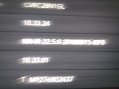

18harvest
Mar 15, 2019
596
292
huntsville
IMG_20191014_220341674.jpg scored a uas from a 2019 ram classic today and discovered a 22.5 application version for a uas.of course to me it sounds like over kill on the bass eq like my uaq.tha manufacture date on the uas had a 2018 date so i tried the 22.6 application mgrimm has for a 18 uas.so far its taking i will know for sure in about half a hour.so if you have a 19 ram classic uas that sounds like crap this may work.but i would make sure the manufacture date is 2018.i don't know if this matters .and don't blame me if your radio bricks i am just being a test dummy your results may vary.and sorry about the pic my cheap moto 5 phones camera sucks.
