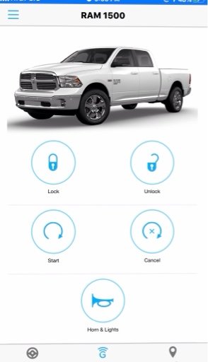

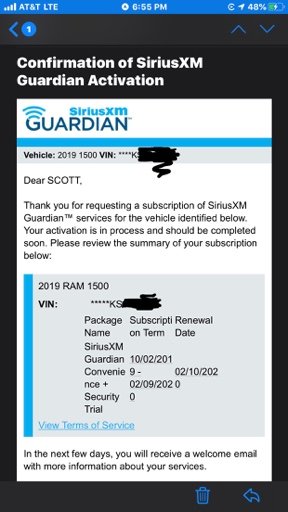

I have been working on it since last night, but I was able to get SiriusXM Guardian activated. It took some finagling and a little bit of paperwork. Because the radio was in a 2019 it carried over and shows up as a that even though it’s installed in a 2016. It is incredibly flaky at best. Assist works occasionally. I get error running IVA application on the radio about half the time. The iOS app works to some extent. Location works 100% of the time. Remote gets incorrect PIN intermittently. Vehicle Info does not work.
00384d995f301b2947d503034a2f6b4e.jpg3c7cc61705b28d8dec5d9c7042e9889f.jpg09338a9c9101b3bc5138b519c22d4ecf.jpga1a6ba3f8e94091cf7eb503e3641906e.jpg
I also got them to activate the Sirius Guardian on the 2018 UAQ (using the donor vin) I swapped into my 2018 that didn't even come with BT. It didn't seem to do anything at all like it wasn't getting a signal even thought I added the sharkfin and the correct cables. I wonder if there is going to be a way to fully activate Guardian in a vehicle that never had it. What radio did your truck come from the factory with @scott_intx ?

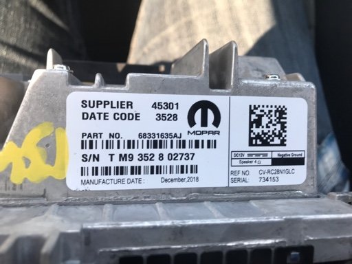

Yeah. What's the PN on that 19 classic radio? Same as the 18's/OP?

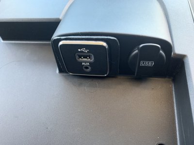

So has anybody ever figured out a way to wire up the USB hub so we can be mounted in the Dash
Like this I have a manual and this was just keep the wire out of the way better

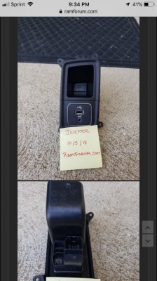

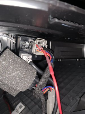

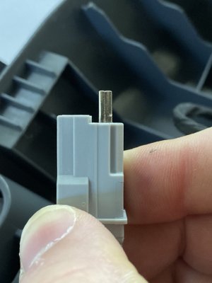

Finally got my install complete thanks Grimm for the harness!

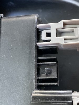

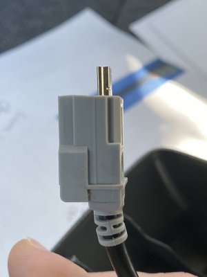

One update about the 2019 USB Media hub. It appears that they have slightly modified the USB cable connector. I had to shave down the front of the connector in order to have it seat all the way into the hub. Very minor, but figured I would share
Clip not seated
Before
After

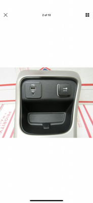

I bought part of the center console out of a 2018 compass and it included media hub, 12v charging port with illumination and part of the wiring harness. So i trimmed around the media hub on the compass console, and used it as a bezel to cover the ugly gap that shows when installing a compass media hub. I also decided to use the 12v charging port from the compass since it has illumination. I used part of the old compass harness to add illumination to my media hub and charging port. Turns out the compass has white illumination. Doesn't look bad. Kinda matches with the cluster. What y’all think? Heres a few pics of how a ran the wire to the hub and how it looks lighted up. I tapped into pin 8 on trailer brake like mentioned above, to get power to hub and port.
