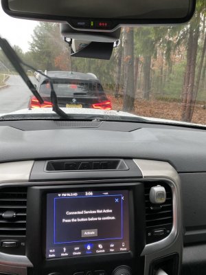

Dealer friend hooked up to computer getting cellular antenna 2-circuit open any ideas ?
Mpgrimm2
Supporting Vendor Navy Badge
Mar 30, 2014
6,588
5,202
SC
2022 Ram 1500 (5th Gen)
5.7L
Sent you a message.
Did you already have a factory 8.4 radio with 3g Sharkfin antenna before the upgrade?
M² Mods.
