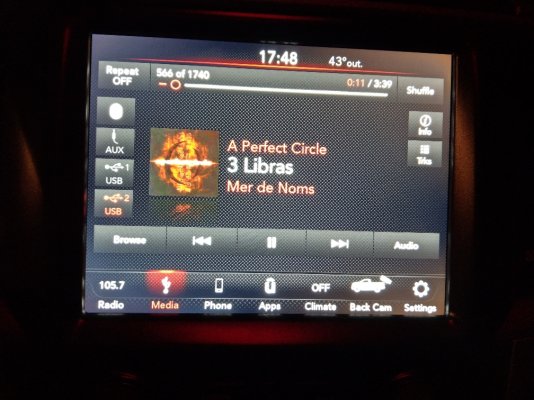

Ok so the exact change is this...if you set it to AUX + USB + extra USB you get a second USB Menu Option on screen (USB 2)...
If you leave it set to AUX + USB, everything works, but a USB flash drive will only read from USB 1 (the plug on the left) and you will only have one USB option on screen.

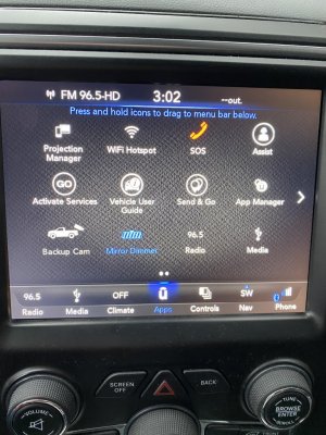

Have a 17 Ram 1500 went from 8.4 non nav to a UAQ. Has anyone been able to get traffic to work on factory nav ? Also Sirius guardian does not work does this go hand in hand with traffic ?
Yes this is it. I finished my install last night, it would only see the 1 USB port. I made the switch with Alpha, called it a night. Got out this AM going to gym, switched my usb from slot 1 to slot 2 and it read both ports just fine...
I had doubts yesterday during the install. There is actually 2 connections on the back of the 2018 USB hub vs my 2015 stock hub. Grey and Black. We only have a grey connector. I didn't know if it would work. but after watching MPGrimms vid, i had faith. Sure enough after Alpha settings, works just fine.
Whats the 2nd connection for??
I think it's for AUX. I was actually wondering if I should plug the gray connector into the back of the black AUX connection to see if it works. If so, you could have all of the inputs working and just lose the ability to read a USB from a second port (the phone would still work through that port though)...

Try this previously posted by Mpgrimm2: TravelLink should be disabled in your BCM by default unless you turned it on yourself using AlfaOBD (SDARS TravelLink Present = YES /NO). You may just need to pull the radio fuse near the brake booster to force a reset to clear it. Or just want a while longer ( up to 48 hrs). Hope this is what your looking for. Mine worked in my UAQ but the free preview expired and I didn’t re-up.

I have it installed for a while now no change. Even activate services will not work. Also rear view mirror 911 and assist buttons do not work. I just get message connected services not active press button below to continue and that button says activat
