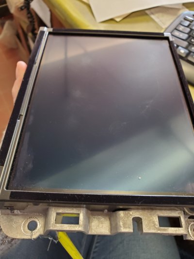

I was able to find a radio with nav from car-parts.com for 450 with I thought was a decent price. But when the radio came the screen is messed up with scratches and small chips on the screen and the screen has this weird worn out area right in the middle. Does anyone know how much a replacement screen would cost and where to find one? Or should I just send the radio back and get my money back and look for a different one?
Here's what I found. Personally I'd return it or see if they would refund some of the money to pay for the repair parts. I found a UAQ not too long ago that the yard said had a scuffed screen but from the picture they sent it didn't look so bad (see picture, they wanted $600)

Cheapest I have found a screen is like to 280.00 it is the screen and digitizer I don't think they're separate like on a ra4.I found some direct from china for under 200.00 but the chances of it getting to USA in one piece wouldn't be that great and it would sucks if it didn't work.the Panasonic screens scratch 10 times easier than a ra4.

Woahhhh that's some coin. You could buy another unit for that money. Yes return if not happy.

Almost impossible to get them off without breaking the tabs that hold them on.i have had luck getting them off and putting them on with a little epoxy.just don't get any in the cylinder or it will get in the plug on the board.be extremely carefully when you use anything to wipe a Panasonic screen if you rub to hard it's almost like the finish comes off.
