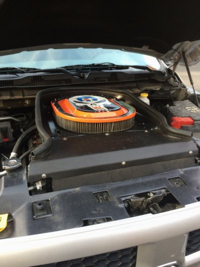

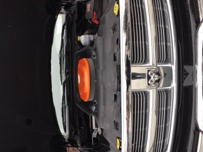

I got it in.
Someone mentioned up top about the horn relocation. It was easier just to grind a notch out for the horn as it sits. I reversed them at first and it still sat funny in that area.
Hardest part was getting the sensor out the original plastic tube.

I got it in.
There are a couple in this thread that have reinstalled the little cover over the grill. How is any air going to get to the filter?

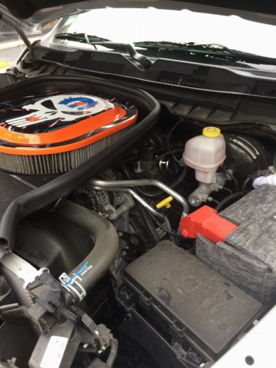

I have borrowed the text from Post #1 and have added some annotations from my experience and some pictures from my install.
***Artwork on the Vararam filter lid was done by Tat2hemi, so if you like it, he's your guy***

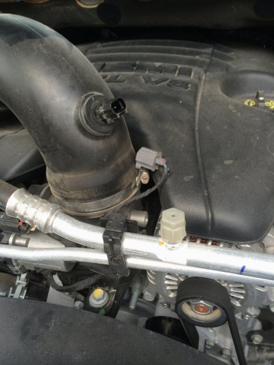

•Step ONE: Remove the OEM air temp sensor by squeezing and pulling on the wiring harness.

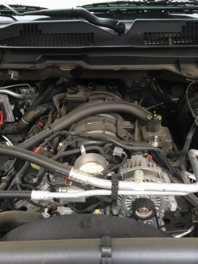

•STEP THREE: Remove OEM intake hose using flat head screwdriver

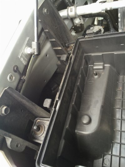

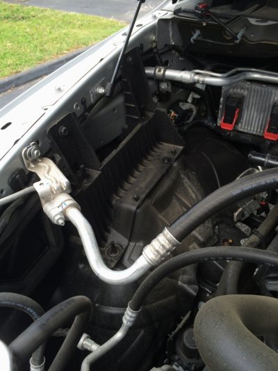

•STEP FOUR: Remove the OEM air box- just pull up this will release with a good strong pull straight up.
*I broke one of my OEM air box tabs by pulling up too strong on this, so be careful*

•STEP EIGHT: Install the air temp sensor at this time, push and twist, You may need to use some lube like W/D You will need your 10mm socket wrench and a screwdriver Install the screws and lock nuts as shown here.
* no pictures of this either, I pushed my IAT in until the rubber o-ring was on the inside of the red tube that mounts on the throttle body. It was a perfect fit. Also be sure that you have your IAT in the correct direction, mine had a little lock pin that needed to be pointed straight up to allow air to flow through the sensor correctly.*

• STEP TEN: Remove the short 45 deg section of the PCV line, this will become your new PCV line. using this shorter end Simply reinstall this back on to the valve cover and push the chrome breather into the short 45 deg OEM hose, you can
rotate the hose in any position desired
*the PCV line is the the black hose that has black foam cushioning around it. In my picture below it starts just behind the oil cap and goes to the OEM air box. You remove that main length of hose and the short 45 degree piece is sticking up behind the oil cap*
You can see the shiny chrome breather pretty good in this picture

FINISHED INSTALL PICS

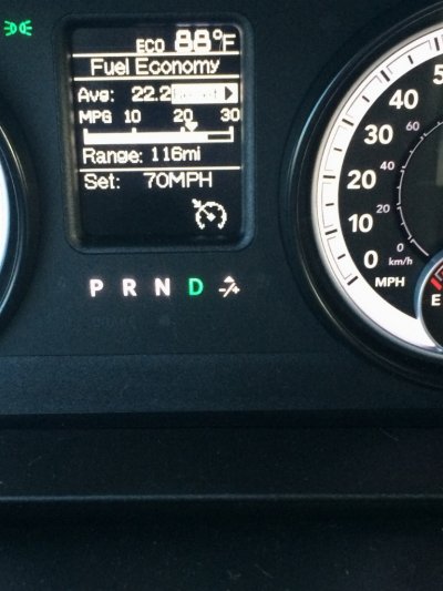

TEST MPG Control Course (30 mile roundtrip to my office, low traffic because weekend, tested right before the install)
TEST MPG Vararam Installed (30 mile roundtrip to my office, low traffic because weekend, tested after 2 hours off batter was complete)
The whole install was pretty quick 40 minutes tops. I unhooked my battery before I started the install so that I wouldn't have to wait as long for the computer to reset. I had check engine light on for the rest of the day. I pulled everything apart to double check, eventually gave up and said I'd worry about it the next day and take to O'Reilly's to read codes, but that night the CEL was gone on it's own.
