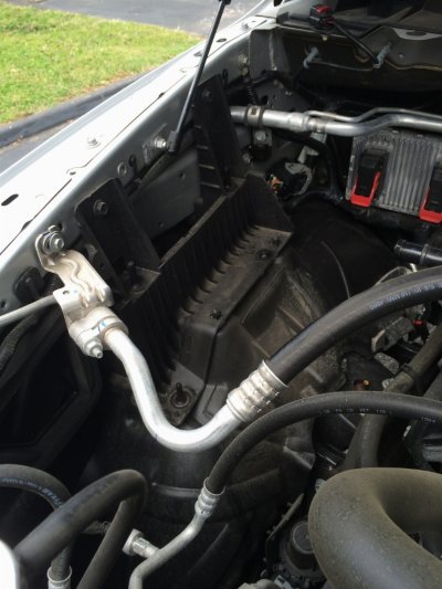

•STEP FIVE: Remove the front shroud cover. Using your flat head , pry these round plastic push clips "UP". They will release with a stiff pull. Remove this OEM foam cover out of your way. (Optional) You may choose to cut out the center section at a later time , so that it may be reinstalled to give a more OEM look.

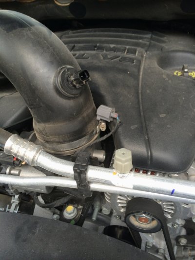

•STEP EIGHT: Install the air temp sensor at this time, push and twist, You may need to use some lube like W/D You will need your 10mm socket wrench and a screwdriver Install the screws and lock nuts as shown here.
* no pictures of this either, I pushed my IAT in until the rubber o-ring was on the inside of the red tube that mounts on the throttle body. It was a perfect fit. Also be sure that you have your IAT in the correct direction, mine had a little lock pin that needed to be pointed straight up to allow air to flow through the sensor correctly.*

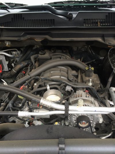

*the PCV line is the the black hose that has black foam cushioning around it. In my picture below it starts just behind the oil cap and goes to the OEM air box. You remove that main length of hose and the short 45 degree piece is sticking up behind the oil cap*
You can see the shiny chrome breather pretty good in this picture

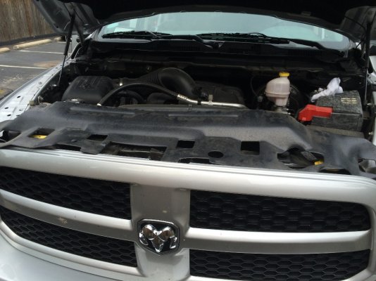

• BONUS STEP 2: Trim the shroud so that it can be reinstalled for OEM look. In my picture I did not cut enough away and ended up going about 1 inch further into the shroud to allow more air. I used a cheap dremel with a plastic cutting disc.

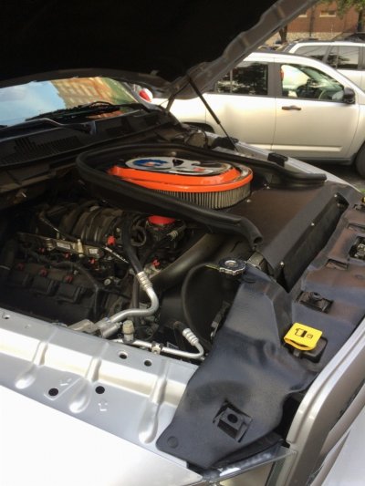

FINISHED INSTALL PICS

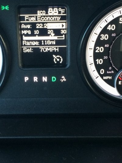

TEST MPG Control Course (30 mile roundtrip to my office, low traffic because weekend, tested right before the install)
TEST MPG Vararam Installed (30 mile roundtrip to my office, low traffic because weekend, tested after 2 hours off batter was complete)
