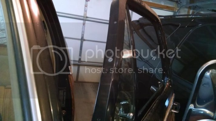

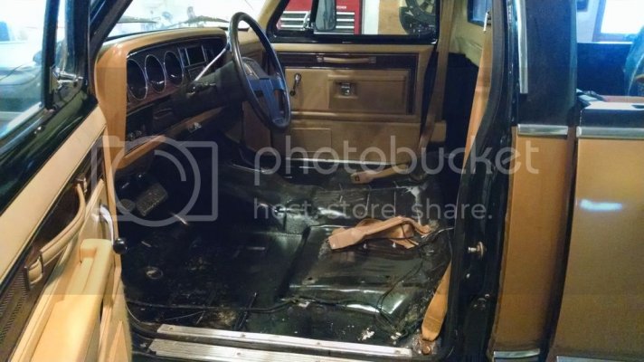

I have another question. There is perfectly good rubber along the cab, but there is no rubber on the door itself. Should there be? Would rubber on rubber contact be the best way to get the water to stop leaking in my door when it rains? It comes from the top area of the door. If someone could show me a picture of how a first gen door is supposed to look? All the rubber and weather stripping and stuff

There's nothing on the door itself, just the piece of foam like weather stripping attached to the cab. If you need to replace it I'm pretty sure 1A Auto has it, that's where I got the vent window seals for my '85.
