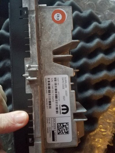

Another update. Decided to poke around with Alpha. Ran the HVAC actuator calibration routine, everything passed. Temperature blend actuator went from full hot to full cold. Then I used Alpha to set the temperature to full hot, and full cold; the actuator went to the according limits. I then tried stepping through the temperature range, and response was as expected. 60°F is just off of the full cold limit. Power cycled the truck and I still have the same faulty response from the on screen slider. This makes me believe the on screen slider itself is not calibrated properly. Full cold on the slider aligns with ~74°F as commanded by Alpha.

Application version 19.9 is the same version on both my UAx Radios and it worked well in my 13 ram & factory 18 UAS truck. What's the PN on your radio again?

That's a valid USA ram radio PN. Hmm. Is your truck a 1500 or 2500
M² Mods.
2015 1500 Express Crew. Originally an RA1, upgraded to an RA2 on my own, then decided to take the easy / safe routo and went with an Infotainment kit for the UAQ upgrade.
