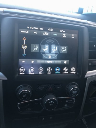

When you set it to single zone ATC using alpha. You should see the temp where the temp slider is. You’re still has the black dot so it’s not enabled and or it has not been sent by the BCM to the radio.
Yours should look like this. Once the single zone activates the auto will pop up.
Did you enable the temp sensor and ATC like it says in the AlfaOBD thread?
