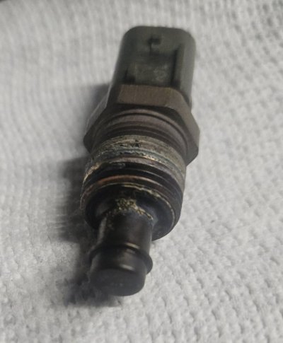

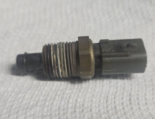

My old coolant sensor:

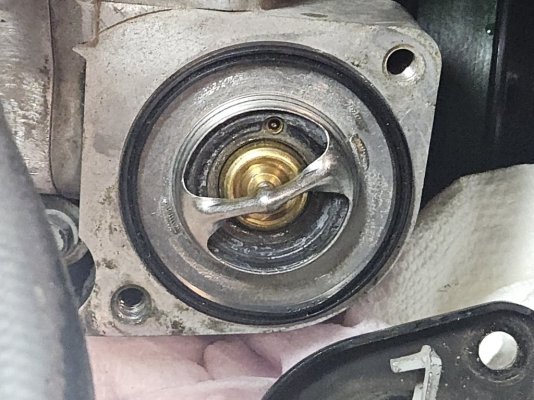

Calorstat 192° thermostat in place:
I like these temps so far, will get a chance thursday afternoon to run her on the interstate, I will post any changes I see in the running temps.
BTW, checking temps at the base of the coolant sensor, the infrared temp gun reads within 2° or less of my EVIC temps. Very pleased.
