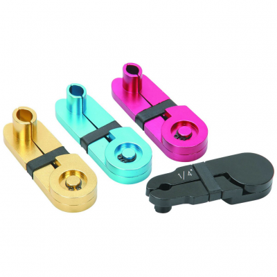

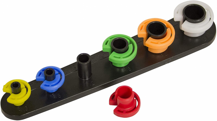

I don't know if this applies to 2008 Rams
But the newer fuel lines have a special plastic fitting at the ends.
Some people somehow are able to release that fitting, but most ppl break it
these tools work faster & easier
