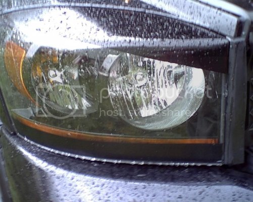

Actually the truck sits high enough so rock chipping is really not an issue. I used vht lense darkening, Yes it's in a can. But it is actually strong stuff. Tape off your headlamps ( too where you like the lid) And do a soft coat, then another soft. This stuff likes too run. I used six or seven coats, My weather sucked for the past month and a half, I wanna paint too match. then clear coat. But right now I have just the vht. It's passable, but not color matched yet. Close, but not yet. I got mine at napa seems too be the cheapest, here's a pic of one side. O6 night runner btw.
