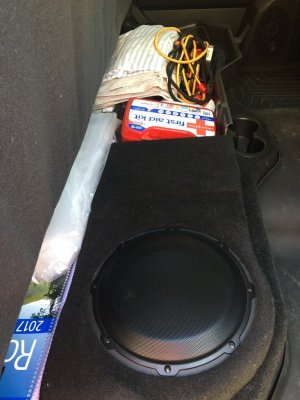

I have this and LOVE it. 500w solo and with full dynamat/dynaliner/dynapad in the cab, nothing else is needed. T H U M P E R
I cut my Duha under-the-seat organizer down to fit the stealthbox. Worked out great.

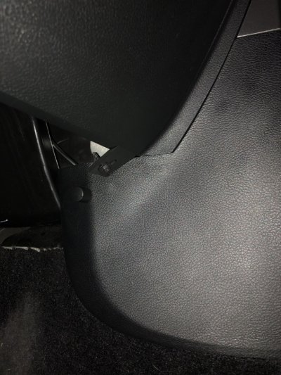

All I did to hook mine up was just use the factory subwoofer wiring under the rear seat with a set of the JL Audio RCA adapters to the input of the JL Audio 600 watt amp that the instructions of the Stealthbox recommends you use. I didn’t put no line output converter on mine, nor did I use that module thing that lets your signal to your bass amp bypass the factory amp, so use either of those two devices on your own account if you plan to us any of that stuff or if you get talked into using it. I didnt use it, and I don’t feel it’s needed. Also, I bought the JL Audio Remote Bass Control knob for the amp so I’d have a way to control the volume of the bass. Highly recommend that part. I also used the Crutchfield 4 gauge or 600 watt amp hook up kit. Definitely follow the recommendations of the 4 gauge power wire and like, 10 or 12 guage- whatever it is, speaker wire.

Place where I stuck the bass knob.
