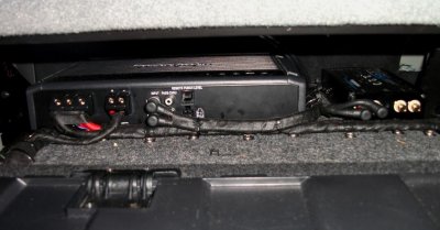

The Alpine enclosure has a four pin connector. I put a meter on them and got 4 ohms from the two right hand pins. Not really sure what that means since I did not take it apart to trace where those wires went.
Here are a few pictures just for fun.

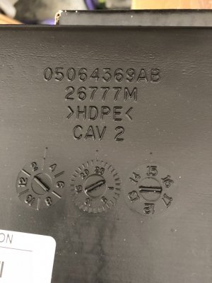

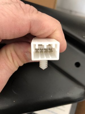

What is the connector I would need in order to connect a new enclosure to the existing cable? A 4-pin to flying lead ...
thanks
Kilrroy
Jun 8, 2020
Oklahoma
2010
... also, what is the pin out for the 4 wires?
