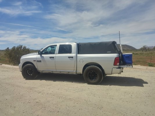

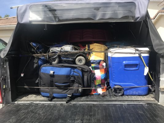

600lbs of weight in the back and she handles dirt without sweating one bit, i need to relocate the spare from the bed. The damn 35 wheel/tire setup in the bed really uses a lot of real state back there and i'm starting to hate having to organize all the chit i throw in there trying to optimize the space left. I'm thinking rather than a front bumper i need to get something like Wilco Hitchgate Solo or similar approach :) bumper will be nice to have but at the moment functionality wise i need more space in the bed. Summer is coming and the outdoor trips with the family will start increasing.
46710537035_7fa16cf6f0_h.jpg2019-04-16_06-31-15 by RAM RSM, on Flickr
40659792463_ec0046b1b6_h.jpgUntitled by RAM RSM, on Flickr

Hahaha sorry wrong thread ^, It's Icon 1.5" in the back so it's still on topic.. i just meant to post this my Build thread :)

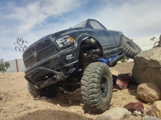

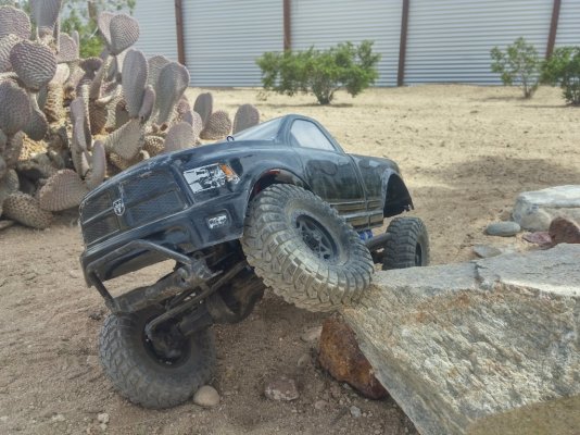

Check out that RC RAM!!!
