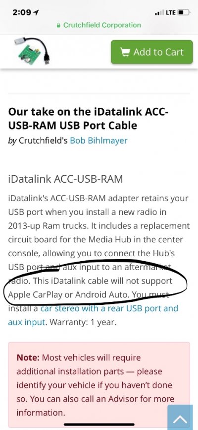

you will have to replace the center usb with the uram usb unit from iDatalink to use your apple car play.
I know this is an old thread, but I have been researching the URam accessory to integrate the USB port. It will not allow you to use CarPlay or the android version through it for some reason. The crutchfield website confirms it.

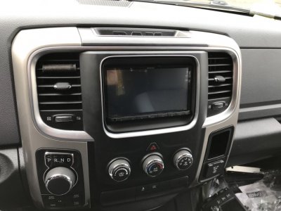

I literally just installed the same radio 10 minutes ago..was getting ready to start a thread on it lol..I also used the maestro. I too had the 5.0 and man what a difference..I wasn’t expecting such a difference in sound quality but is literally night and day. The equalizer and crossover/fade settings are just the cherry on top..I got this for the apple car play but man I’m loving how it sounds.IMG_0040.JPG
Correct, it will only allow you to retain the USB port, but car play will not work. I ran the usb extension cable that came with the unit down through the center stack behind the trim and under the glovebox/passenger foot area-out of sight out of mind and my lighting cable is always plugged in so not much worry there.
I have the idatalink uram in place of the original usb hub, and CarPlay works just fine.
Interesting. Now I’m not sure what to do. Someone else on here said it wouldn’t work, and crutchfield says it doesn’t either. Guess I’ll chance the 20 bucks.
I can confirm it works for the pioneer avh-4200 nex (everyday for a year) and now my alpine iLX-107. The alpine is wireless CarPlay, but the uram is plugged into the usb input on the alpine for when I need to plug it in.
They must've updated the board or some trucks have a better USB cable than others. My uRam never worked right for Carplay or Android Auto, but I know others have. I ended up replacing my 12v socket with a USB/HDMI port connected to my iLX207. I actually like that location better since I can stick my phone in the factory phone holder and use a short lightning cable to plug in.
