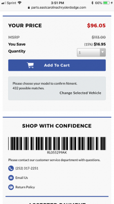

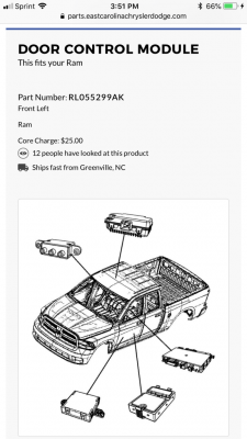

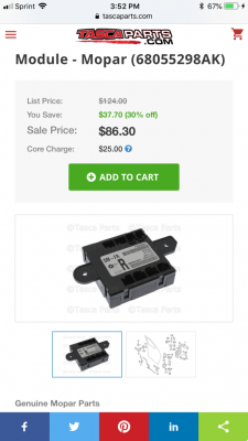

Dealer said my floor carpet is very wet. Wished I would have noticed it. Local dealer said if i buy the door module and harness from them, they will program them for free. Canbus sucks! Dealer i took it to wanted $700 to fix it including parts. I just called triple A to tow it to my house. Ill be doing the swap myself. $400 for labor??? I dont think so!
Module is $100 and harness is $110.

Yeah each door has its own door control module. Then the harness goes to the master switch. More electronics always equals more problems.

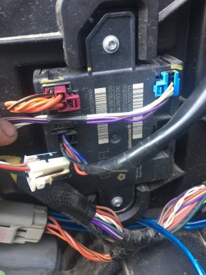

Went to the local salvage yard today, got a used door module and the whole door harness and the drivers side plastic door sill cover all for $90.
I can now operate my windows, and did NOT have to have the door module programmed. I attatched pics of the white plug that is scortched and melted. Unplugging the harness where it meets the door took some work to get loose.
Just figured I would post feedback about programming.

I forgot to mention the dealer wanted to charge me $600 labor. Rediculous. I was going to just splice in the new pigtail to my old harness, but when i cut the ground wire, it was completely black. Had no copper color whatsoever. I didnt want a bad connection or maybe the burnt ground was what caused the module and plug to melt. So i replaced the whole door harness.
The window regulater plug was a nightmare to get unhooked/rehooked. Only way to get it removed, is to unbolt the window regulater from the glass, drop it down, and take it out. But I was able to wiggle my hand up in there and unplug the window regulater module.
I made sure I used dielectrical grease on all of the plug connections. Dont want to have to do this a second time!

I am doubting there was a leak. Im thinking lack of dialectric grease feom factory caused corrosion from moisture. Only two of the plug sockets on the door module were corroded. Other two were fine. I ended up taking off the passenger door panel and putting grease on the door module plugs there as well just to be safe.
If your truck is a little older, I highly reccomend putting dialectric grease on the plugs.

I honestly didnt see anything wet behind the door panel. Im thinking whoever tinted the windows, when they sprayed the soapy water on the window, trickled down and slowly shorted out the module because there was zero dialectrical grease where the plugs were. I pulled all of the plugs off and put grease on them.
