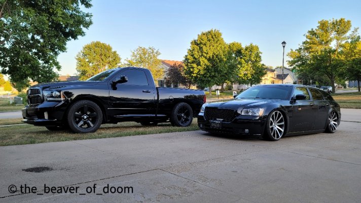

You rub with a 3/5 drop? That IS weird. When I was running the 3/5 I had the stock 275/60R20 size and had zero rub. Does it rub in the back or front? I did get an adjustable rear sway bar to re-center my rear end because the pass side tire would just kiss the lip of my bedside. The pic below is the truck with the stock tire size and the 3/5 drop. I have since dropped the front 2 inches with the Belltech kit for 4x4 trucks and cut another 2 inches off the rear springs. I am now running 245/45R20s. I think the sidewall is a little too short. Next set of tires is going to be a little taller.

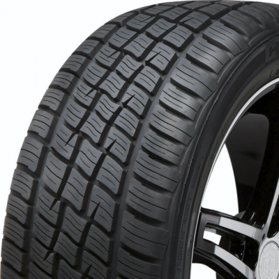

That first tire looks like what I was looking for. Did you like that tire? What were they?

The front will be lower then a 3 inch drop without the isolator. "with Ride quality being the #1 goal. We achieved that by lowering the front end with custom control arms. You achieve the 4” with the lower control arm. We add 1″ spring isolater to set at 3″ (this is a quote from the IHC website. I believe the isolators are supposed to sit in the spring pocket of the new lower control arm with the spring sitting on top of them. I have a 4WD so my front end kit does not use isolators.
Stock springs and shocks are used to keep the ride quality. The stiffness should be exactly the same as it was before the drop. The IHC rear shocks should keep you from bottoming out. The new ones are shorter and the kit moves the lower attachment point for the shock.
The tires I was running on the 3/5 kit were Cooper Discoverer H/T Plus in the stock size 275/60R20. I loved these tire. Much softer then the stock Goodyears. Ride was better road noise was better. Grip was better. Looked more sporty then most truck tires in this size. I only went with different brand for my new tires because Cooper did not have a tire in the size I needed.

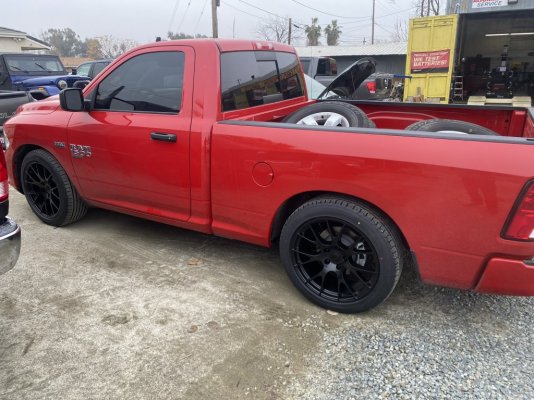

I just lowered my 2022 Single Cab with a 3/5 kit from IHC. I love the look but, I wish I could lower it another inch or two. IMG_5030.jpgIMG_5031.jpg
Bigskyroadglide
Moderator
Member Relations Specialist
Moderator Supporting Member
Nov 9, 2016
2,742
5,841
Montana, officially RETIRED
Hemi 5.7, supercharged
Take out the lower front spring isolator and the 1 inch rubber spacer on the top of the spring. Leave the top spring isolater that molds to the upper spring coil, that should drop it 2 more inches in the front.
For the rear, take out the rear springs, sit them on the ground measure a 1 or 2 inch additional drop and Cut the coil with a grinder, not a torch or plasma cutter. 1 inch is a little over 1/2 a coil, 2 inches is a full coil or more.
Most people cut the right coil more than the left to account for the gas tank weight
Be aware, the lower you go, the more problems you get. Check drive shaft clearance for potential rubbing. You will need to change tire size as the front will rub the inner fenders.
Here is mine at 4 in front, 5 in back. You cannot see much difference in the rear, but can see the difference in the front. I'm 285/45/22 in the front and on my 2nd set of inner fender liners.
