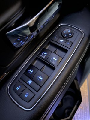

This is what you need. Pic from another member. I saved it because I want one too LOL

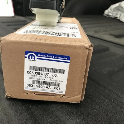

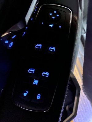

Like the link posted by Greygoose, part number is 68319803AA
That is a single connector switch for a 4 door truck....I dont think there is an illuminated mirror switch for a regular cab. The older trucks use a double connection switch, so the part numbers doesnt work for them either, but since you have a 2019 (I assume a Classic?) that switch will work.
Its like a 5 minute swap....get a plastic trim removal tool or even maybe a popsicle stick, pry the existing window switch up and out of the door panel, unplug it, plug in the new one and snap it back in.
