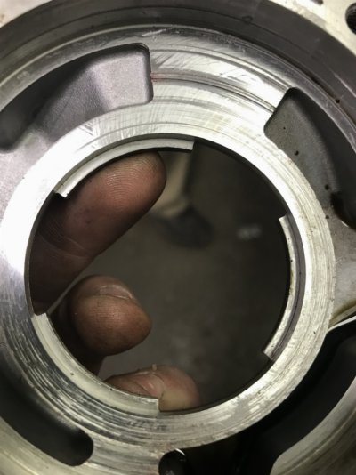

If you had any type of engine damage with metal floating around, this is probably what your oil pump looks like on the inside
If you are taking the pistons apart to change the bearings you need to replace the connecting rod bolts. They are Yield To Torque, which means they can’t be reused. If you need new piston heads, I HIGHLY recommend getting the block a cleanup overbore and bigger pistons. I made that mistake and had major problems. Also have a machine shop install the press fit piston wrist pins, you have to heat the connecting rod to do it. If you overheat the rod you will ruin it. Trust me I know.
Your lifters maybe worn out, look into replacing those. Head bolts need replaced as well.
