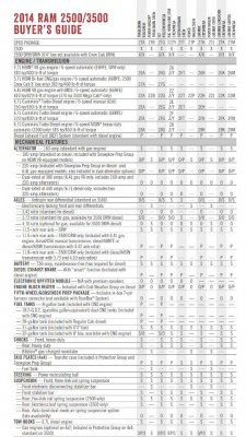

The factory doesn't make Hemi powered HDs with the second alternator option nor do HDs offer an air ride system. They do offer the rear air leveling system if that is what you are referring to.
What are the DTCs?
crash68
ACME product engineer
Mar 20, 2016
12,356
21,503
3.0 EcoDiesel
The factory did offer dual alternators on the 6.4 Hemi for 2014 model year.Screenshot_20180911-060007.jpeg
