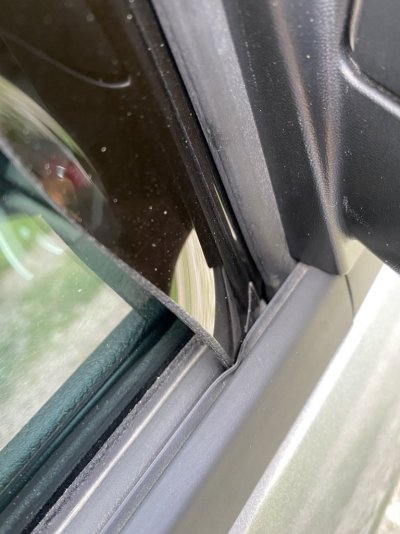

Is there any luck with using in channel window vent visors on the 5th gen trucks? I tried to use them on my 4th gen and I couldnt get them to work. The window kept stopping and going back down. I tried two sets but to no avail. I wound up having to usie the stick on visors. Just curious if the 5th gens may be better

I have the AVS in-channel ones on my 4th Gen, no issues. You just have to put upward pressure on the window glass the first time you roll them up, then leave them rolled up for 24 hours. (The process was in the instructions for the AVS ones).
