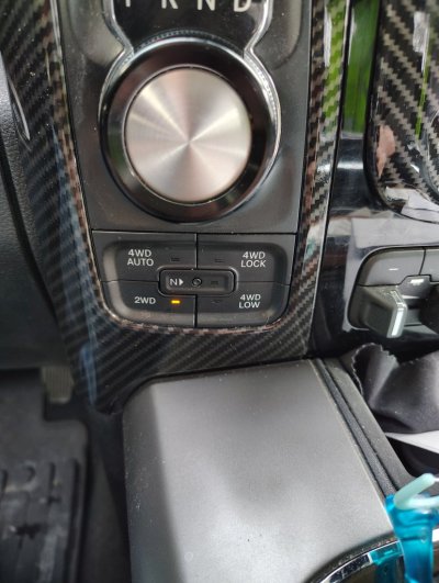

I figured it out.
I while ago I had an air freshener hanging above the switch and the alcohol from it peeled the paint on the dash . So I put an overlay on the dash which goes around the drive switch cluster. So the overlay is just slightly pressing the 2wd button which doesn't allow it to go into a different mood. I lifted it overlay up a bit and boom I can go into 4wd. Thanks for the responses.

Scott View attachment 577147
Glad you figured it out. Self inflicted wounds are very common. This is just one more example of why it's a good idea to include a pic or two when asking for help. Someone might have noticed the overlay is in contact with the 2WD button from the pic you posted after you figured it out.
