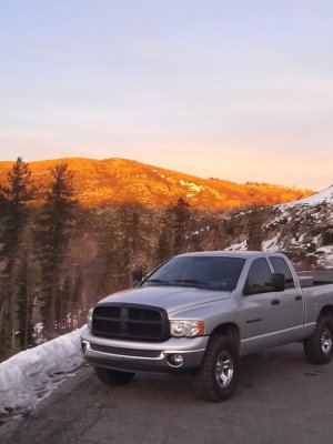

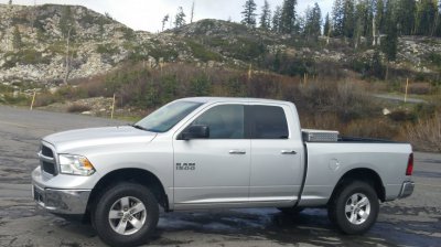

Im going to post both, My 13 and 04.
My 13 has a 2.5 inch lift in the front nothing in the rear, im running 33s
My 04 has 3 inch in front add a leaf in the rear. I ran 35's with minimal rubbing,
My 13 Cost about 350 for lift alone but i did tires so new tires mount balance and lift came to about 1400
04 was already done when i bought it added 35's
