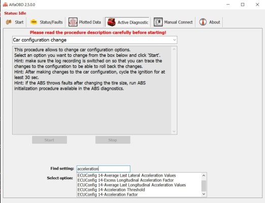

If you want to emulate what a pedal commander does and improve your throttle change two settings in AlfaOBD:
To Change go into AlfaOBD and follow the steps below:
Body Control Module -> Diagnostics -> Car Configuration Change
ECUConfig14 /Acceleration Threshold: Filter Off
ECUConfig14 /Acceleration Factor: Filter Off
This made a huge difference in my throttle response. I've seen a few people debating whether it actually does anything but I can confirm that if you set it to those settings you will feel a difference in throttle.

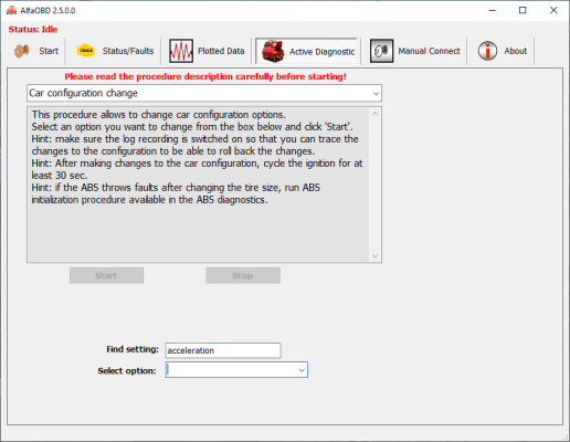

I have the Windows version of AlfaOBD I cant find those settings for a 2011
WWlorodd1
Nov 26, 2017
39
21
Fort Worth, TX
2011 Ram Sport
I dont see that even when I try typing acceleration.

RamDiver
Jan 23, 2022
5,591
11,788
Marlborough, Ontario Canada
2021 DS
Is it because its a 2011?
This option must not be available for your truck year.
Anyone have a list of things I can do with AlfaObd on a 2011?
What happens if you click in the find setting box?
On my '21, a window pops up and I can scroll through a large list of options.
Hemi395
Mar 18, 2013
9,503
17,658
Cape Cod MA
Sounds like the older trucks don't have this setting. My 2013 comes up with nothing if I type "accel", I have the Android version
I could find nothing related to Pedal, Acceleration,or threshold for my 2010, unless it's called something cryptic, or one of the general options in car configuration I do dont think it is avaliable for 2012 or older CGMs
