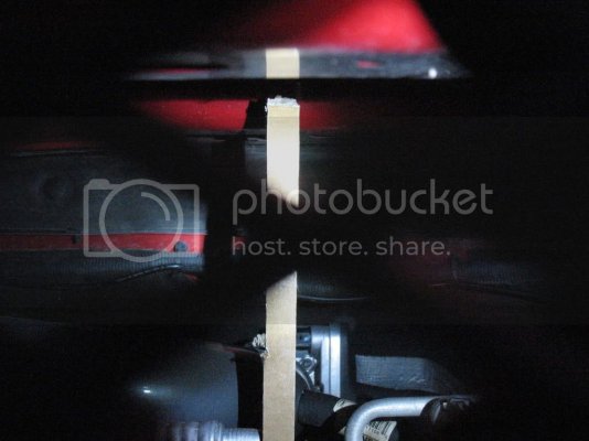

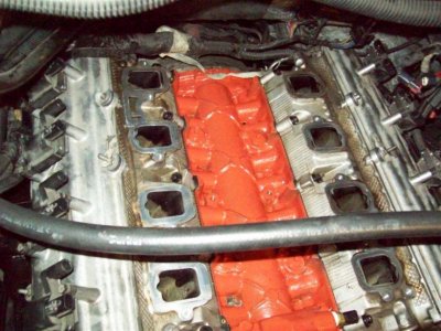

Place I measured from on drivers side, sat ontop the valve cover on the front
On the pass side ontop of the valve cover with the CIA holding it up

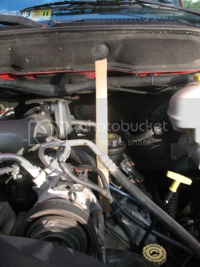

14" cardboard strip

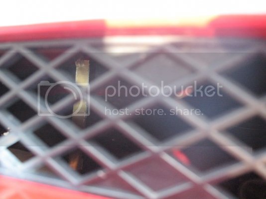

Pass side with hood closed 14"
Drivers side 14" closed

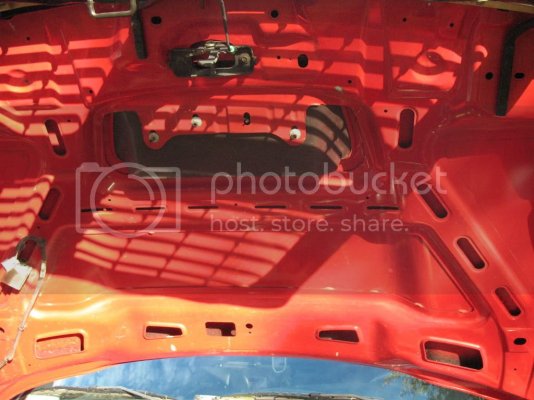

Under hood bracing and lay out
I tried 15" and they cleared, 16" folded up on the driver side and close on the pass side. I think the supports are gonna be the issue if your needed more then 15"

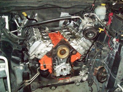

Well I finally got my slacker ass in gear and am in the process of 5.7 removal, should have the stroker fired up tomorrow afternoon!! I took a good look at my stroker shortblock buried underneath my winter coats and decided to get my *** in gear. Also a pic of a column dual gauge pod, I'll have the trans temp on the right, wideband on the left, and the oil pressure in the SRT-10 pillar pod.

Bout time Sam, you still gonna run a Stu version of the Comp 273?
Yep that's whats in it now. Didn't get it done today, got a later start then what I wanted and just ran out of energy. Need to give it a bath when this is all done, pretty grungy under the hood. Running the stock heads for now until I can afford the 09' heads, but I'll be installing a ported 6.1 intake in the next couple months.
