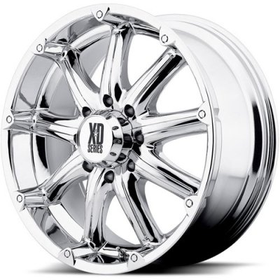

All right I am looking at ordering my wheels and tires here in the next few weeks and like many others I would like to have opinions on what I am ordering on wether they will fit.
I have read everything I can and everything points to this set up working just fine.
Iam on bils at 2.8 with TTC-1211S and 1" spacers with Timber Grove air bags.
Wheels are XD Badlands 18x9s with -12mm offset which is 4.5" bs which is one inch less then stock. So this is pushing my wheels out 2" or so from where they set now.
Cheapest I have found is on Ebay for $1,136. free shipping.
Tires I am looking at BFG KM2s in a 35x12.5x18s, I have read these are not a true 35" tire but around 34 to 34.5 but still a 12.5" tire.
Cheapest is $1,196.00 free shipping
I have also been looking at Toyo MTs 285/75/18s , a 35" tire but not as wide at 11.5" so might clear alittle better.
Seen these at $1,325.
Then tpms, do I get these from Ram ? or are there good after market ones.
Thanks for any input.

I have had and used both tires you have there on everything I can throw at it.
I'd show you pictures - but photobucket is having a melt down and crying.
The KM2s are GREAT tires. However, they are softer tire than the Toyo and won't last as long. I really did enjoy the KM2s on my 1500. Air-downed they'd crawl over anything I threw at it!
Toyos are great, harder and won't get a puncture as easy. Last a lot longer. Still a nice quiet tire.

I had the Toyos on my Cummins and really like them but was thinking of doing the BFGs just to run a different tire.
I like the fact the Toyos are 10ply and dont like the fact the BFGs are not and only 8ply.
But then I am not sure it matters that much on my 1500.

To give you an idea I had these on a bone stock ram 1500 . They are 20s on 35s and they rubbed just a little bit . I used my Factory TPS

Thanks for the pix, do you remember the offset om them?
on a stock height Ram huh, I should be fine then.

I think you should be fine being a smaller wheel , you'll just have more tire . Let me see if I can find my email receipt .

I can't find it but -12 seems to be about right .

What I could find -12mm in these seemed to be the most common offset.
