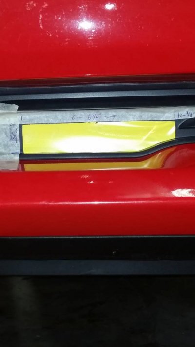

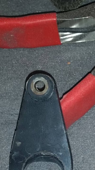

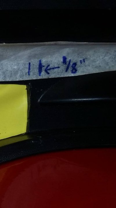

For some reason my photos in the OP are broken ?
And since this latest update I can't EDIT my own older post .
Anyway , here's a few pics that may help anyone reading the OP , aka post #1 Original Post .
Hope this helps !
