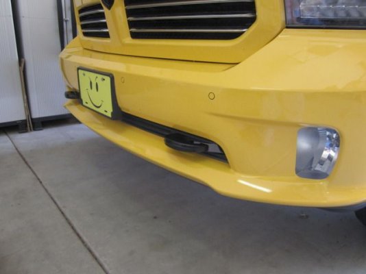

Quick question for anyone who has used Ken's brackets (or made your own version, @JB1 ). Do these get mounted to swing the hooks inward or outward?

iNWARD-

outward towards the foglight, your goal is to move/pivot that hook from the frame mtg point to be centered in the outer larger area without having to cut those ribs so height is also a concern

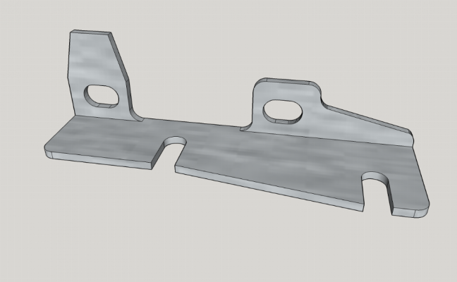

You still working on a design?
kad
Jul 10, 2017
2,788
2,331
Hudson Valley, NY
5.7L HEMI
Yup. Actually the design work is (hopefully) done. After many cardboard prototypes and fittings I'm currently in the middle of making a set in steel. Got the major drilling and cutting work done Wednesday, I was going to do the final grinding, filing, etc last night but the weather wasn't conductive to doing anything but sitting inside in the air conditioning. 90F and near 100% humidity isn't my thing. :) With any luck I'll be able to get back to working on them on Saturday.
Sneak peek:

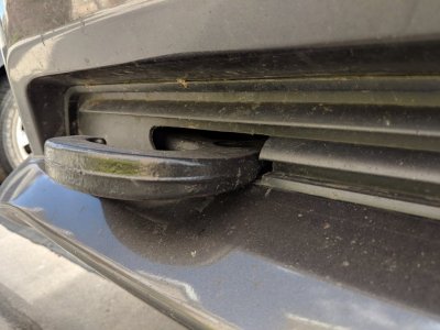

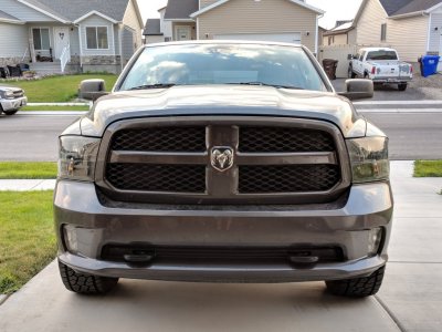

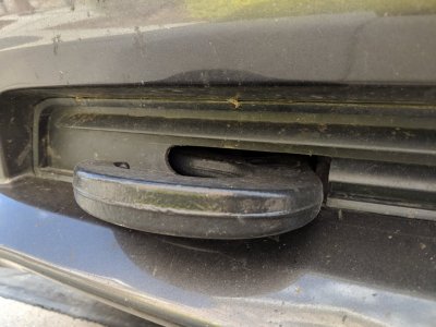

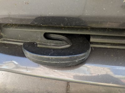

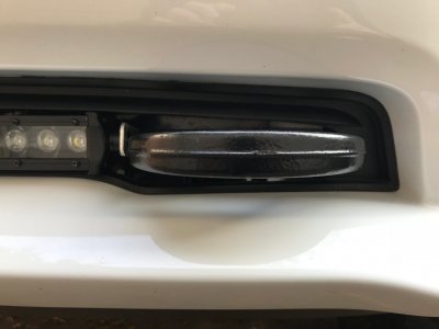

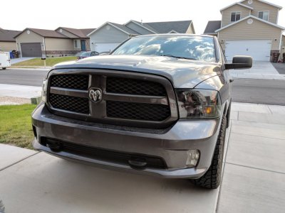

I needed the hooks so I already installed them too. I found this thread before I did it but I couldn't wait so I just cut the insert. I'd still be interested in a set of brackets though if someone starts offering them for sale, because it looks like it's pretty easy to buy a new insert to cut new holes. Here's the part number: 68207015AA
Here's how mine turned out, I didn't cut any of the painted bumper, just the insert:
