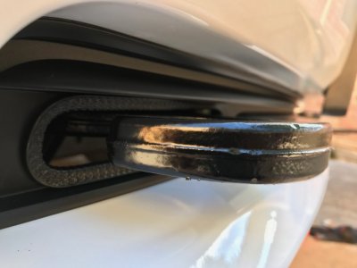

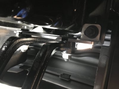

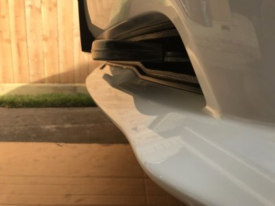

update....I am in the process of revising my first design. I will still have to get a couple sets made of the new ones and try them first before release. However once finished the fab shop can just crank them out to my final design.
My latest version allows them to fit more accurately in that open space of the plastic trim.

What is that trim material you are using on the cut edges?
Sent from my HTC One M9 using Tapatalk
JB1
Nov 3, 2011
8,366
7,542
Houston, Texas
Its just some edge trim with a grip I got off amazon. The grip is a little tight and the material somewhat stiff so I might try a different style/size. When I decided to make the bracket at a drop height to fit that gap, I also wanted to be able to cut the opening and leave approx. 3/16" to 1/4" edge for the trim to attach too. I tried to cut the opening as straight as I could but wasn't perfect so this edge trim makes up for any imperfections and gives it a finished smooth edge.
