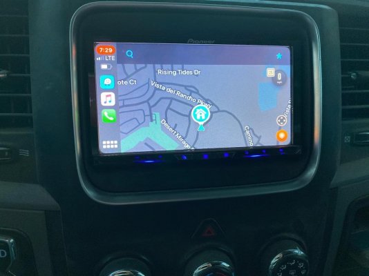

I got my radio and all gear needed to install it from crutchfields. It took me about a little over a 1/2 hour to install and I think it turned out pretty good. 7758265224355b7ee535ef74914b35be.jpg
