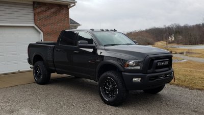

Installed 37’s today. BFG KO2

What a difference these made in the snow and ice. They rub at full lock on the drivers side part of the sway bar. Here is a pic. Sorry about the quality. It’s so nasty and cold. My truck isn’t going to be clean for a while. Another pic added with mounted height.
Swapped mine to 37" KO2s right after I picked it up from the dealer. Run them on all my 4x4 vehicles.
The 33s just looked too small. I changed wheels too though, so I didnt rub.
I need to chalk test mine to get the pressures right, but what pressures are you running yours at ?

I’m running about 45 in the front and 38 in the rear. Seems to be wearing nice. Nice ride too. Looks like I could lower them more but I’m fine at that pressure

Thank you, they put mine around 60 front and 55+ in the rear , I may drive it one day a week, so it hasn't had many miles put on to see the wear pattern at that. It does seem a bit darty when on the highway like my Wrangler did with over inflated tires. I'll drop mine down and drive it around the rest of the weekend and see if it feels better. Thanks again for giving me a baseline to experiment around.

You might want to lower those since 37” KO2s have a 50 psi max pressure. Ouch. No problem. Seems really good at where my psi is set at.

Yes, as Reuben said, definitely need to lower them to 50 psi or less before you drive it again!!!
