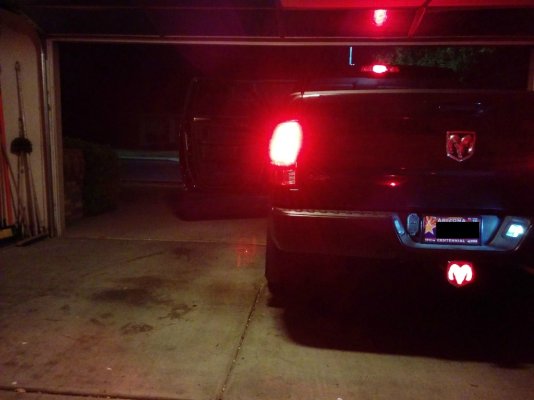

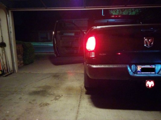

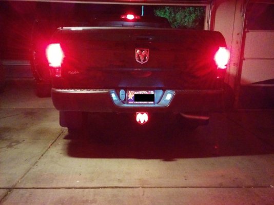

Also, I forgot that I never uploaded the pics. So here they are (all taken without flash):
Parking lights from behind truck
Left parking light from directly behind it
Brake lights from behind truck
Left brake light from directly behind it
The cool circle each parking light leaves on the wall behind it when I'm close to the wall (and the brakes, much brighter).
