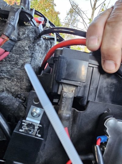

Is there an empty fuse in the fuse box that is linked to the accessories power?
Must it be a fuse that fits in the fusebox? There is an Accessory lug on the side of the TIPM itself you can attach too.
It doesnt need to be fused, I just thought that was the easiest way, but if there is an accessories Lug that would be the best, Where exacly would that be located?
