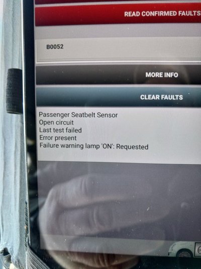

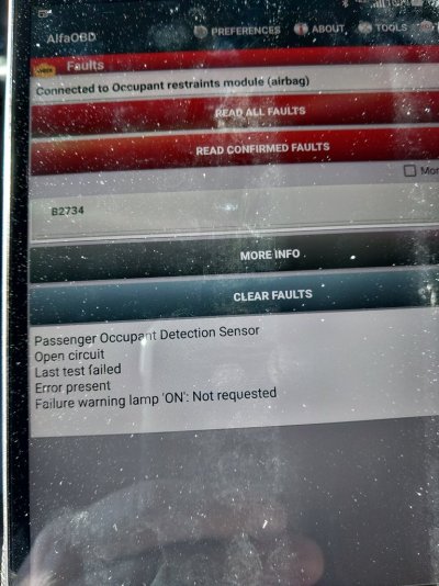

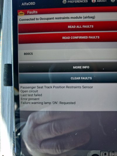

These are the codes that came up how would I go about fixing this

They're all codes for the passenger seat, there probably a problem with one of the wiring connectors. Probably one or more of the wiring pin connections are not making good contact causing the faults.

I think I have it figured out I pulled the seat back out and was looking at it looks like it's missing three sensors compared to the 21 seat going to try swapping those sensors over and pin those into the plug see if that fixes the problem

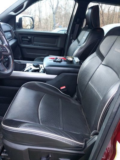

I got the passenger seat all figured out My other issue is I watched a video on YouTube about programming to get the heated and vented seat functions to work and I can't get the soft keys on the screen to populate would anybody on here be able to help me out with that
