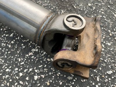

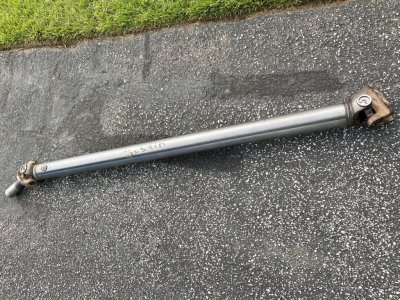

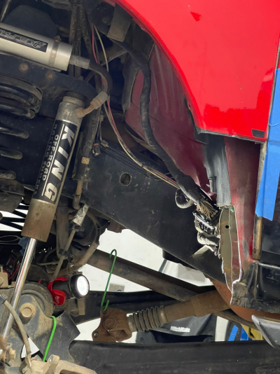

Unintended mods are always the best *rolls eyes* I was under the truck for something unrelated, and discovered that I had become VERY lucky on the trail. My drive shaft took a direct hit and had a big dent in it and did not grenade itself. Instead of putting another OEM drive shaft in, I had A-1 Drive Shaft Co in south Baltimore rebuild the one I had using the stock ends. Since the one I had was only bent and not destroyed, there was little guess work and they had it back to me in 4 days. It looks like it’s about an inch smaller in diameter than the OEM aluminum one. I’m very pleased with their work. If anyone is in the area and needs a drive shaft rebuilt, definitely hit them up.

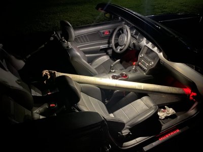

Good thing my other vehicle is a convertible, so I could get it to the shop lol
New and improved steel drive shaft

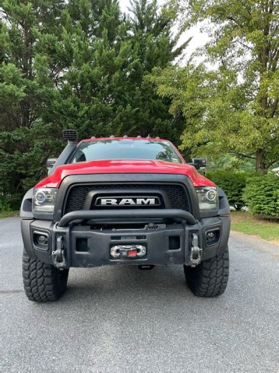

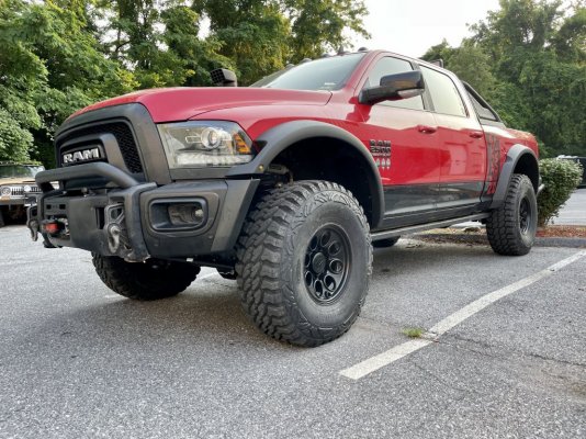

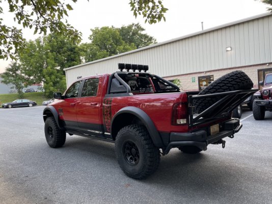

It’s time, for the big reveal! Finally was able to pick the truck up tonight and I could not be happier with the results. I just love how this turned from me not wanting to spend $1,200 on a steering upgrade to spending well into the five digits. But after many months of anticipation, here she is! Big Red came out of surgery sporting:
-AEV High Mark fender flares
-AEV Katla 17x10 wheels
-ProComp Xtreme MT2 40x13.5x17 tires
-PSC hydro steering assist kit
-Yukon 5.13 gears
This thing is an absolute beast now. I actually have 6th gear back when driving. I feel literally no drag on the tires, it drives better than before and I thought that it drove perfect before this, worlds better than it did stock. This combination is as close to perfection as you’ll get. The gear selection was perfect, the tires are nice and cushy, and it looks completely ****. I don’t have the same photoshopping skills that @UTAHPWRWGN has, so I’ll have to work on getting better pics!
Oh and to those that have been playing along with the home game, the hydro steering was the component that I was teasing months ago. Once I ordered that, the shop owner (who is a close friend of mine) said “you know I’m going to want to cut your truck up and do flares and 40’s, right?” and that’s all she wrote.

Your truck looks amazing, congrats on the good decisions.

Looking totally awesome sick!

BAD ***! Keep us posted on any ball joint/suspension issues, just curious how they hold up to the 40`s
I did have to get new carrier bearings in the front during install. He said they were pretty beat up, estimated I’d probably need new ones again in 40k miles since the factory ones lasted about 55k.
