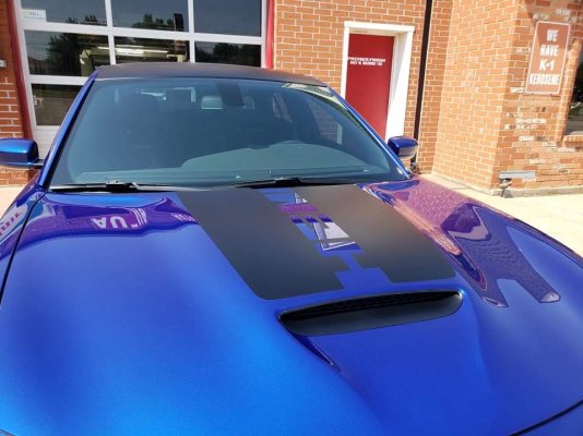

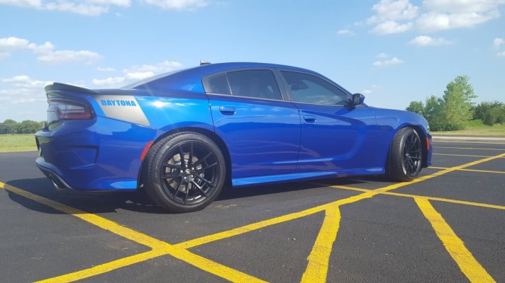

Agreed, I have done the Griots 3-1 on my Jeep, but had my blue Charger done professionally, and was the best finish for as long as I owned it.

Professionally done and they couldnt even dry it for ya? ;)
those pics were like a month after, heres right out of their shop.
