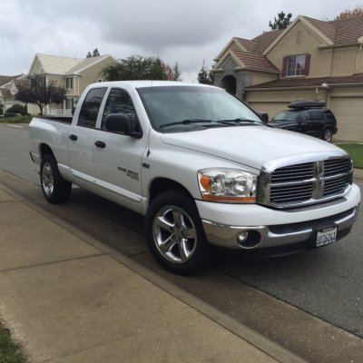

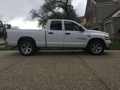

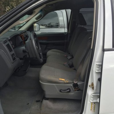

I'm looking for a pickup for the sole purpose of transporting my dirt bike to riding spots. Was looking for a Tacoma but my dad's colleague is selling his 2006 big horn edition with a 5.7L Hemi or $9k. It has 130,000 miles on it. I've been doing some research and found that a lot of people complain this model year has a problem where it randomly shuts off while driving (2006 Dodge Ram 1500 Engine Stalls/Dies While Driving: 14 Complaints). This seems to be the most severe issue, and carcomplaints.com categorizes it as a clunker. The thought of the truck randomly shutting on a highway at high speeds is frightening. Should I avoid this year and keep looking for another model?? I've attached pics of the truck
