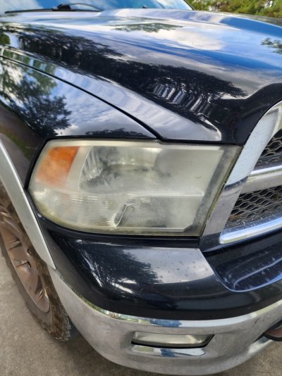

Including a picture of mine on my 2012 Ram. I've tried working on these several times, using wet sanding techniques, polisher, etc. Basically every suggestion I've read about. I've never been able to get them looking new. I'm wondering if I should just replace them. If so, anyone have suggestions on what to order?

I have never had good luck with aftermarket headlight assemblies. The reflectors always seem to be subpar - poor focus. OE assemblies appear to be $355 a side. If the oxidation is on the outside, you should be able to wet sand and remove it. If the discoloration is on the inside (condensation) that's a bit different.
You could try taking the truck to a detailer to see what they say.

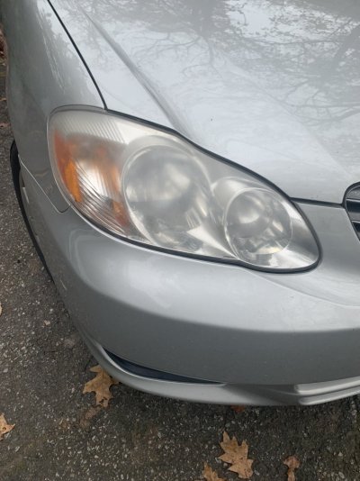

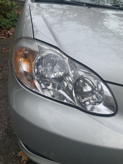

Turtle wax headlight restoration kit is always my go to. Just did my daughters 2004 corolla.
These are what I put on my 2011. They look good, especially with the gray truck
