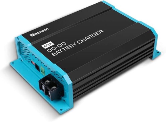

I want to replace our heavy, bulky 3500W gas generator with a Renogy 40A DC-to-DC Battery Charger (for charging our RV's Lithium Battery bank). But, will this damage our 2017 5.7L Hemi RAM 1500 truck's alternator?

I stumbled onto this thread as I run a Renogy 50amp DC-DC charger on my 21 Classic with the 5.7 Hemi and have been for a couple of years. The title of this thread is very misleading as there is no issue running a DC-DC charger with the Hemi and it's alternator. Sitting and idling for long periods of time is a potential issue for the Hemi. Using a DC-DC charger while you are cruising down the road is not a problem.
The OP would be much better off throwing a few hundred watts of solar on the roof of the RV to keep the batteries up, granted it's unlikely to keep up with an AC unit but it beats the crap out of running a noisy generator. That's one of the reasons we don't camp in campgrounds if we can help it.

Thanks for the great response! I have 1200W of solar and a 3500W generator for the RV. The problem is when I camp at 10,000 feet during the summer months in the Southwest; the clouds and the altitude both collude to lower their charging outputs to the 300 amp/hours of Lithium batteries quite drastically. And since you've actually been running the Renogy 50 amp DC-DC charger on your 5.7 Hemi for years with no problems, I'm inclined to take that chance too, since the alternative of sitting in a cold, dark RV with no power doesn't sound very fun to me...
Here's the Renogy unit I'm looking at:

That's a lot of solar and a decent battery bank. My 2 cents, you might want to increase the size of your battery bank to extend your battery range.
I run the Renogy 50amp dc-dc with the built in MPPT solar controller (which won't work for you do to the limit on it's solar input), but I do not sit and idle to charge the battery and based on all the above posts it seems ill advised to do so due to low oil flow issues at idle with the hemi.
