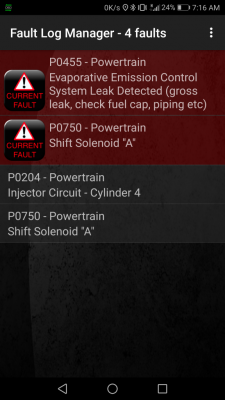

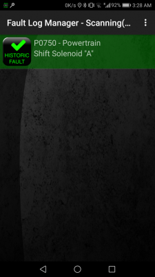

Getting frustrated now, can't even tow or I risk getting stuck. First one is code it threw 2nd time back in Dec, last one is from last night.
