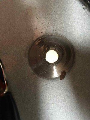

No, no worries there. See my edited post up top. That wire brush bit will save you a ton of time and get it bare metal in seconds. I also like to put a second self tapper screw more towards the back on the ring terminal just for extra contact or incase it gets loose.

I don't see any bare metal, unless they did it to the exact size of the ring terminal. (which I highly doubt) When I do it, it typically is at least 1" by 2" just so I know I have enough contact. This could easily be your issue.
Pick one of these up: http://www.homedepot.com/p/Lincoln-...gclid=CMSShLOw8MoCFUgkhgoddMsJeQ&gclsrc=aw.ds and sand down to shiny bare metal, then place bolt back down.
It looks like the did sand it the same size as the ring terminal

Well I'll be damned lol... never seen someone make a perfect circle like that. I need that tool.

So half that circle still had paint on it. I ground it down to metal and reattached the ground wire. Turned the gain back up on my amp and tested for 10 mins! It is working flawlessly so far!!! Could that bit of paint make a difference? I need to turn the gain up more and keep testing but so far it's working!!! [emoji3]

Yes... grounds are very sensitive and can cause all types of issues. I am glad you are in business so far.

I would still test to see if the spot they used is a good ground. After that I would check to see how the LC7i is set and make sure its set by the book.
