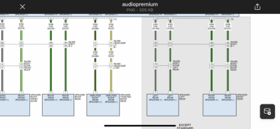

I grabbed it from the pillar between the front and rear doors. Just pull the trim off and you'll see the wires running up to the connector that goes to the door. Theres a bunch of wires, the speaker wires are the only ones twisted together. I used this diagram to confirm wire colors as well.
Anyway to get a clearer version of that wiring diagram?
Strange, on my computer it’s fine, but when I look at it on my phone, can’t ready anything.
try this (for rear doors only):
B
bigred90gt
Jul 25, 2017
906
671
Better, ill have to open it on my laptop also which i almost Never use anymore!
This is about as good as I can get it. It’s really clear for me. Let me know how it looks on your end

I can definitely read it, little blurry on the pos/neg but i can see whats what.
