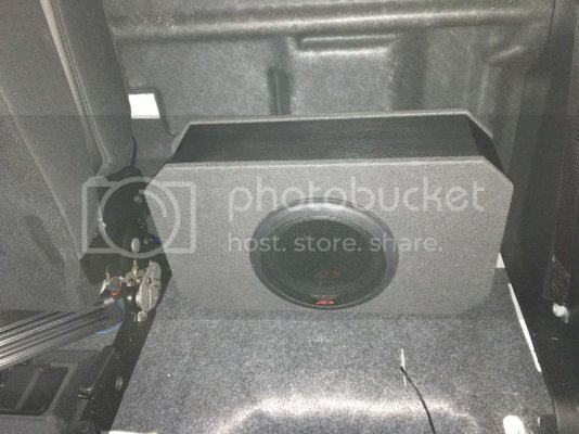

Test fit Alpine SBR-s8-4:
Install and wire up amplifier/line output converter (I tapped the factory sub wiring):

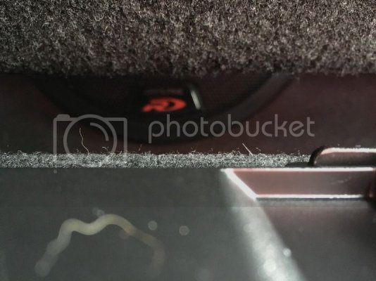

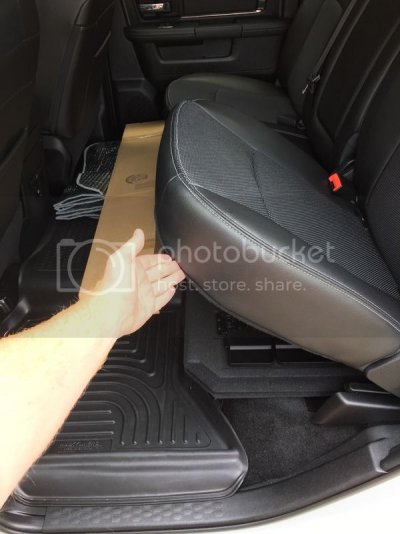

Reinstall seat (pic under rear seat when lifted):
Finished product (seat doesn't fully lift, but you can access under seat storage and with force, get the fold flat floor out):
Note that I did trim about 1/2" from the rear seat hooks so that I can get access to the sub if needed, but that may not be required.

Is that the highest the seat will raise after the install? Do you think if a thinner box was used or if the seat risers were installed would the seat function as it should. I want some subs but don't want to give up my storage bins. I have an old JL 250/1 itching to thump again. Very good write up thanks

If you cut out the rear felt cover there's another 2" of space that you could move the box further back and there'd be no interference with the seat then. That rear cover costs about $100 if you ever want to replace it.

That is the highest I can lift the rear seat, but it's enough to get to the storage bin.
