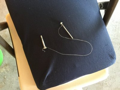

There are plenty of how to's and videos explaining the process of removing the badges online but I have a tip to help you out. When I was using the fishing line to saw through the tape on the back of the badges my hand were getting worn out from the fishing line. I decided to make some handles to make it easier. I just tied each end onto a bolt I had lying around. It helped immensely.

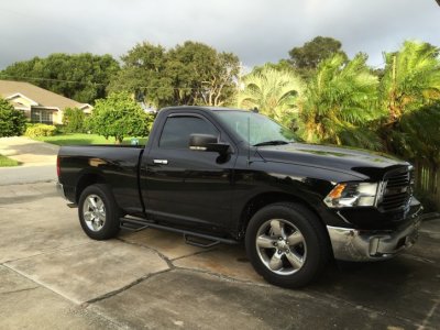

Ok so I finally got the replacement N-fab steps on. I got the textured ones.
http://www.n-fab.com/products/sfID1/67/sfID2/83/sfID3/68/productID/399

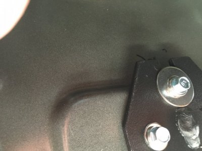

A couple things to keep in mind. 1st off the instructions want you to install 3 bolts on each bracket (2 at the bottom, and 1 at the top middle) with nut plates. The 2 on the bottom work as the pictures show but the top middle one does not at least for my application (2014 standard cab). First of all they want you to put the bracket on and tighten it. Then trace out the "U" portion of the bracket so you know where to align the nut plate for the top bolt. Unfortunately the nut plate will not go on fully because there is not enough room (see second pic down). The area where the plate fits into stops short. Besides that, even if you got that to work then you have to drill a 1/2" hole at the location for that bolt. You would be hard pressed to fit a drill in there. You would need a 90 deg drill and either a stubby drill bit or a uni-bit.
What I did instead was use a self-tapping screw in place of the bolt with a fender washer and lock washer for that location. They also include 2 other holes in each bracket for optional self-tapping screws. I opted for this option. See below pic for the self-tapping screws I used. There is a small amount of adjustment up and down you can move the steps prior to putting any of the self-tapping screws in. Although it would make it very difficult or even impossible to get the upper middle self-tapping screw in. I opted to hold mine down as far as possible. Reason is I am relatively short (5'6") and have a bad knee. I will be doing a level on the front with Bilstein 5100's eventually so this was a no brainer for me.
So now that they are installed......how do I like them? Well, so far I love them. Being a large man as I am (350ish), if they can hold my big a$$ I'm happy. Well they do hold me and I'm not worried in the least of them coming loose or moving. I'm ultimately happy with the way they look as well.

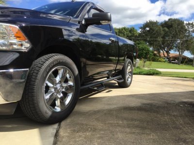

A couple more shots.
