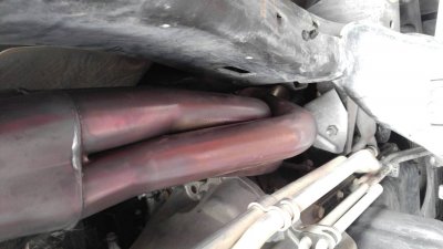

Be prepared to fight the Y-pipe, and DO NOT try installing it until the headers are installed and tight. If you do that you might get an easier install of the Y, but I'd put money on you having leaks at the exhaust ports. If you have time and/or another vehicle, install the headers, mock up the Y, and cut it so it fits nicely. Then get it welded up where you cut. That's what I would've done if I could've gone without my truck for a few days.

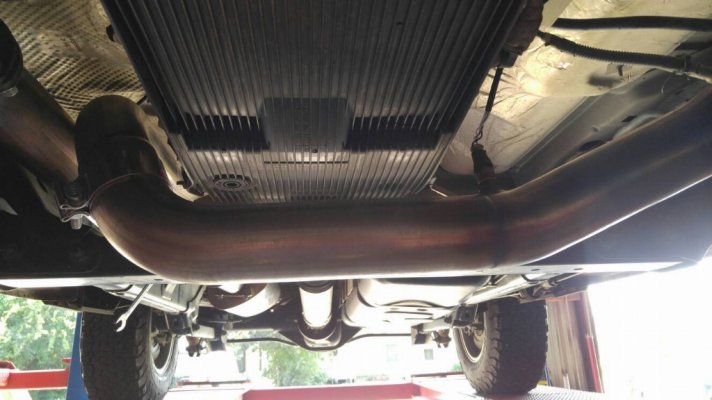

That thought had crossed my mind to.Both our trucks had the Y just about touch the composite pan where it bends up to the other pipe,and you have lots of clearance. I cut my Y pipe's one collector off,bolted it to the header and then re-welded to gain a bit more clearance,but I still don't have the amount of clearance you have.Maybe JBA has been listening,and has re-jigged the Y to fit better to,is another thought that had crossed my mind,lol. Did you have to dimple the front tube for steering shaft clearance?
Maybe they are. I did not dimple the pipe for the steering. I haven't heard or felt anything.

Make a fairly sharp right turn and give it some throttle,if it's going to bind the steering shaft,it'll happen under those circumstances.
How long ago did you buy your Y-pipe and who did you buy it from? JBA didnt offer an 8sp compatible Y-pipe until about 6 months ago. They also did not change the part#, so its very likely that you just received old inventory, or bought it before JBA made the changes to allow it to fit the 8sp as well. I have plenty of 8sp 4wd customers using the same Y-pipe, and they have the same clearance that Kyle has.

Bought about 8 months ago,from a shop in Edmonton Matt.A buddy also bought his at the same time,and had the same issues as I did,the Y pipe on both trucks just about touches the composite tranny pan.I had just enough room to put 1 wrap of header wrap around the Y,where it almost contacts the pan.Ask Kurtis,he's looked at my truck when it was on a hoist.Personally I think JBA's jig is a bit out of whack for fitment around the 8 sp.By no stretch do I have anywhere near the clearance as in the pic's posted above,and no my truck has never been wrecked or went through a ditch,lol.
That's why you had trouble. JBA did not release the new 8sp Y-pipe until March of this year, so the one you bought was 5/6 speed specific. The new Y-pipe clears the 8sp transmission without any trouble.
